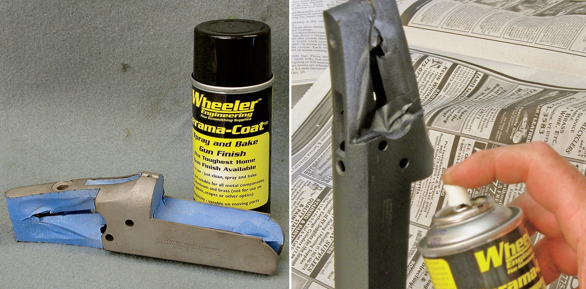

Tape off any areas that you don’t want to coat. Now make a hook with a piece of wire to suspend the part in your oven, and test it to make sure you can easily suspend it without any of the coated surfaces contacting the oven or rack.
Hang the part from the wire outside or in a well-ventilated area and spray well with degreaser like Tipton Insta-Clean, letting it run off. Let the part dry, then repeat, again letting the degreaser run off the part, then air dry. Do not touch the part with your fingers.
Suspend the part in a well-ventilated, dust-free area. I simply use a long hanger on the peg board behind my workbench and a wire. Then I cover the bench with newspaper. Shake the Cerama-Coat for at least a minute after the ball starts rattling. Make sure to time yourself to get the benefit of completely mixing the paint.
Do a couple of test sprays on the newspaper to get a feel for the spraying process. Now spray a thin, even coat on the part. Several thin coats are far better than a single thick coat. Let the coating dry for at least 30 minutes. Actually, this allows the volatile carrier agent to flash off, as the coating does not actually dry. After 30 minutes, apply another thin coat. Let it dry, and if necessary, apply a third coat.

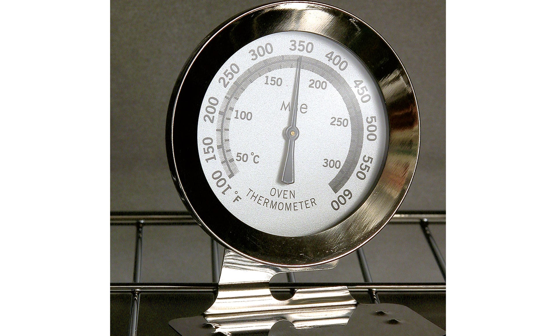

After the final coat has dried for at least 30 minutes, the part can be baked to cure the finish. Pre-heat the oven to 350º F. It’s a good idea to use a thermometer rather than relying on the oven’s temperature setting to be accurate. Carefully suspend the piece in the oven, making sure that none of the coated surfaces touch anything. Bake at 350 degrees for one hour. Do not try to rush this by using a hotter temperature, as that can cause the finish to burn and change color. Also, make sure to bake for the full hour, as less time or lower heat may cause the coating to not set up properly.

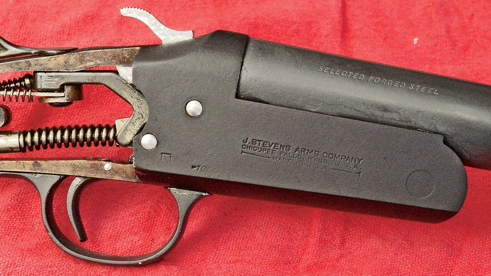

At the end of the hour, remove the part from the heat and allow it to cool. Reassemble the gun and you’re done.
The Stevens shotgun refinished by the author exhibited a great deal of rusting and corrosion before it was refinished. After sandblasting and degreasing, the frame is now ready to be coated. Areas not to be coated have been masked off with tape. When spraying the Cerama-Coat, it is best to suspend the parts to be coated. Several thin coats will produce a more even and attractive finish than one thick coat. The oven should be pre-heated to 350° F. Curing should never be done in the kitchen oven, because heat will release trapped paint fumes that will then wind up in your food. To avoid this danger, the author purchased a small toaster oven at a discount store for less than $100. The author’s shotgun now has a protective, if somewhat utilitarian, finish after the application of Wheeler’s Cerama-Coat.
