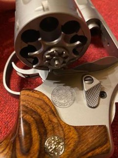

    Dirty Extractor Star
    The extractor star pushes the live or spent rounds clear of the cylinder when the extractor rod is pushed. A dirty extractor star can interfere with the rotation of the cylinder, interrupting the cycling of the revolver. A dirty star can also interfere with the hammer operation by preventing the round from being properly seated against the cylinder.
    This problem occurs due to improper cleaning or shooting dirty ammunition. If you own a revolver, learn how to properly clean it after shooting and become familiar with all the moving parts that are important for the cycling of the action.

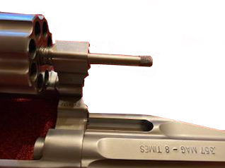

    Bullet Creep or Bullet Jump
    I have heard of this problem for years, but was not sure how often it occurred. That is, until it happened to me! Bullet creep, or bullet jump, can stop the action from cycling. This usually occurs when shooting large and powerful magnum loads. As the revolver recoils from a shot, the bullet of other cartridges can jump out of their case. For example, if your cylinder rotates counterclockwise and the bullet jumps from a cartridge on the left side you can just swing out the cylinder because the bad round is on the side that the swing out occurs. It the bullet jump occurs on the right side, it blocks the cylinder from swinging out.
    This jump is just enough to stop the cylinder from rotating, because a bullet is protruding out the front of the cylinder. Sometimes bullet jump or creep can be dealt with by swinging the cylinder out and extracting the round. Other times, the bullet needs to be removed from the case. This needs to be done very carefully and ideally by a trained individual because what you’re doing is taking the live round apart.
    What causes this type of stoppage? It usually occurs when the bullet of reloaded ammunition was not properly crimped in the case. This is why it’s considered a good habit to only carry factory-loaded ammunition in your self-defense handgun.
