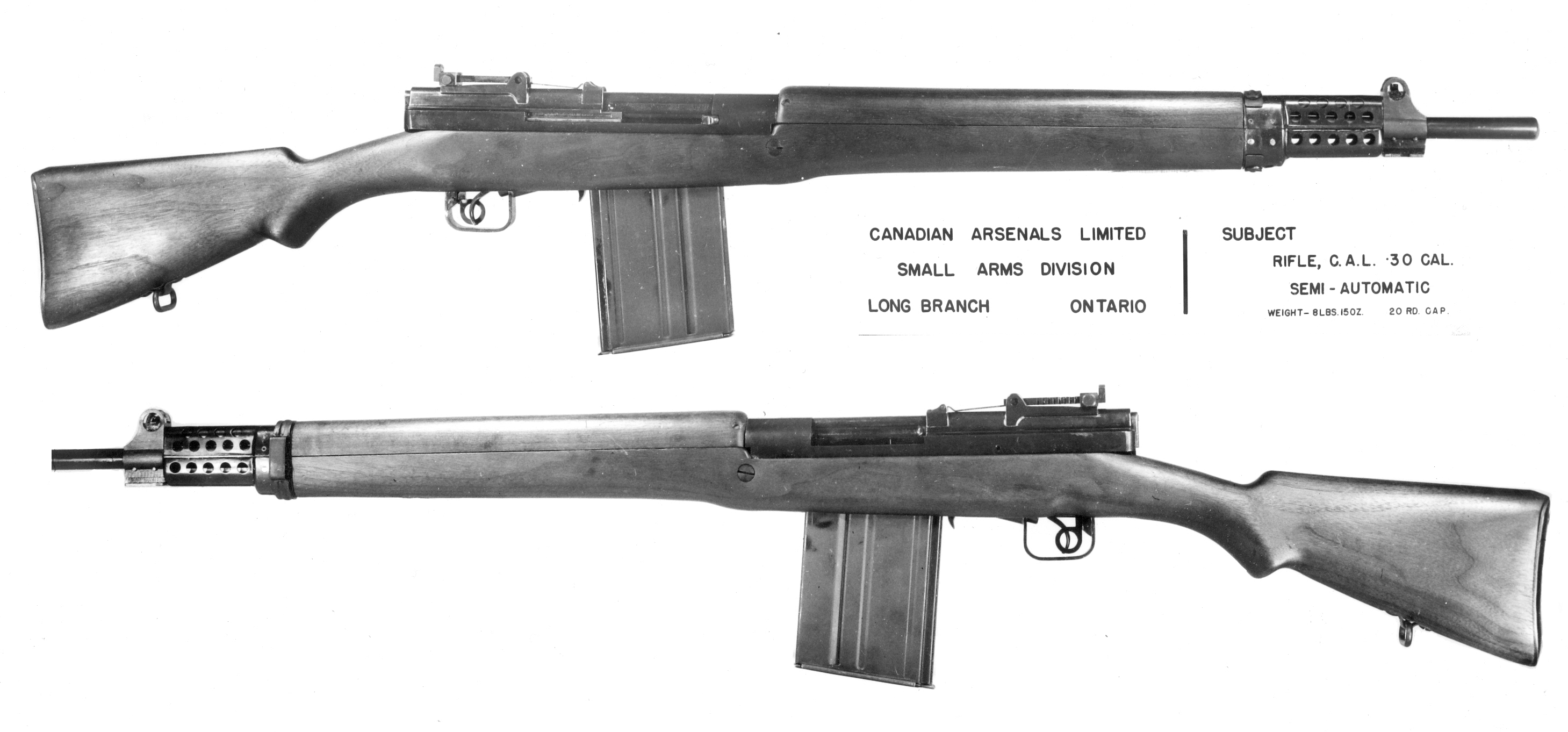

    Canadian EX-2 rifle, .30 caliber. Not sure if this is chambered for the T65 cartridge, as the magazine appears to still be of the ZB-26 pattern, longer than necessary for the T65. Source: MilArt photo archives (click to enlarge)

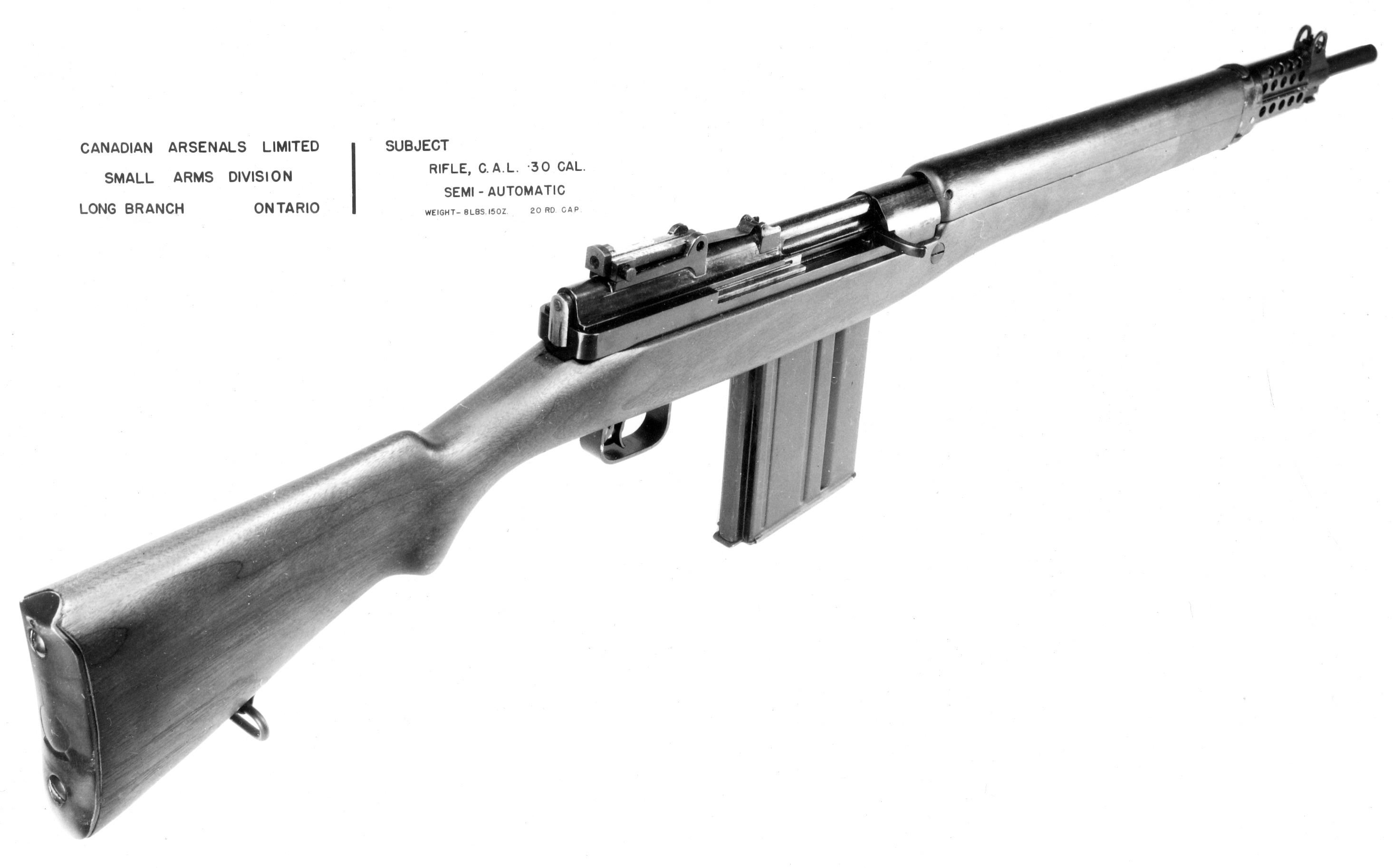

    Another view of the EX-2 in .30 caliber, with a long action magazine. Note the similarity of the rear receiver cover to the FN-49 rifle. Source: MilArt photo archives
