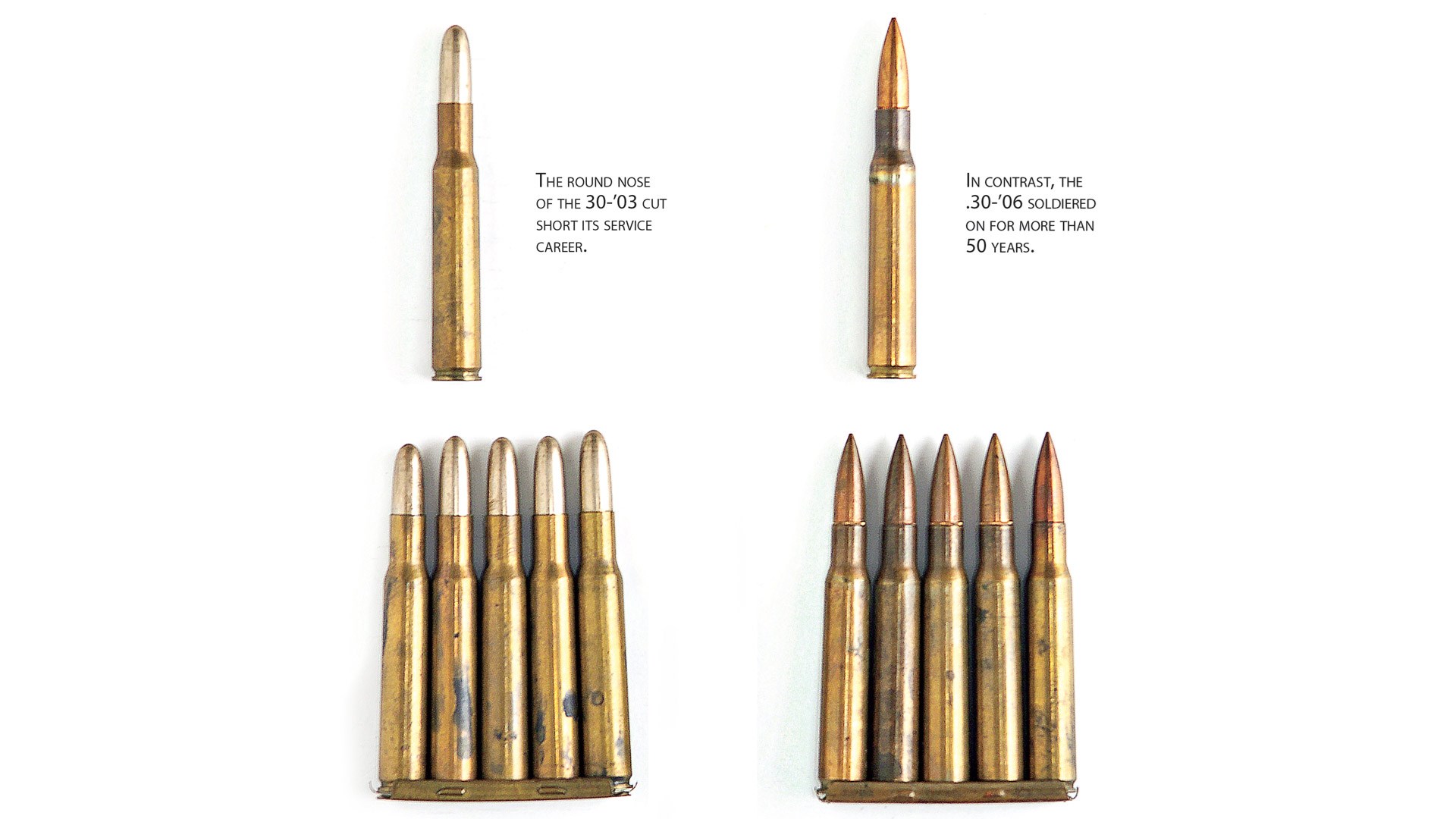

In October 1906, a new cartridge incorporating the spitzer bullet and improved powder was approved for adoption by the secretary of war as the “Cartridge, Ball, Caliber .30, Model of 1906.” The leaf of the rear sight for the new cartridge was graduated to 2,800 yards. (rather than the 2,400 for the .30-’03) and the battle range was now 547 yards. The .30-’06 was born.
Soon after adoption of the .30-’06 Sprg. cartridge (.30 caliber, adopted in 1906), the manufacturing tooling was changed to accommodate the new cartridge. Many of the existing .30-’03 barrels were modified to .30-’06. Due to the slightly shorter dimensions of the new round, it was necessary to rechamber the barrel, which resulted in the length being reduced by 0.200". It was also necessary to shorten the stocks and handguards by 0.200".

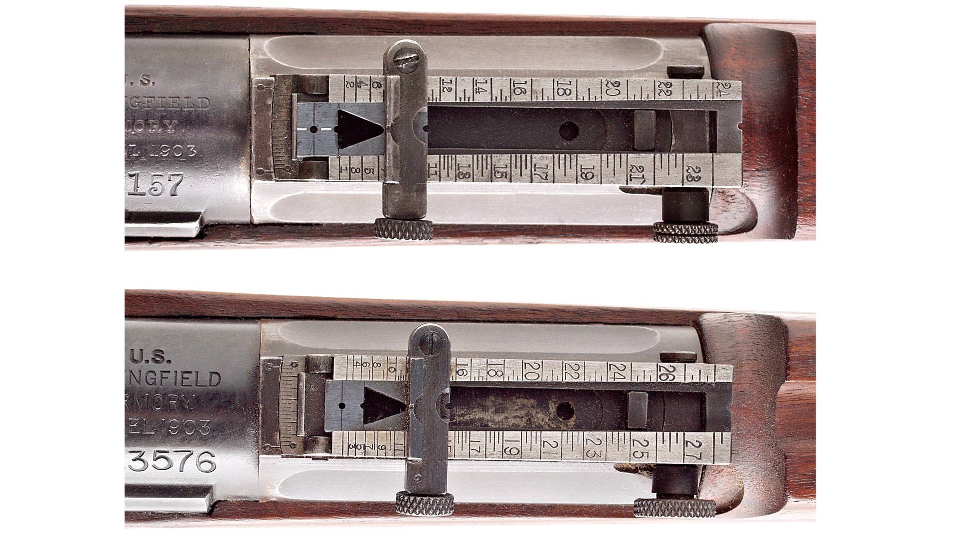

The increased range provided by the spitzer bullet of the .30-’06 required changes to the M1903’s sights. Those of the .30-’03 (top) were calibrated to 2,400 yards, while those of the .30-’06 were extended to 2,800 yards.

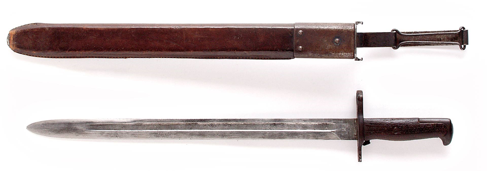

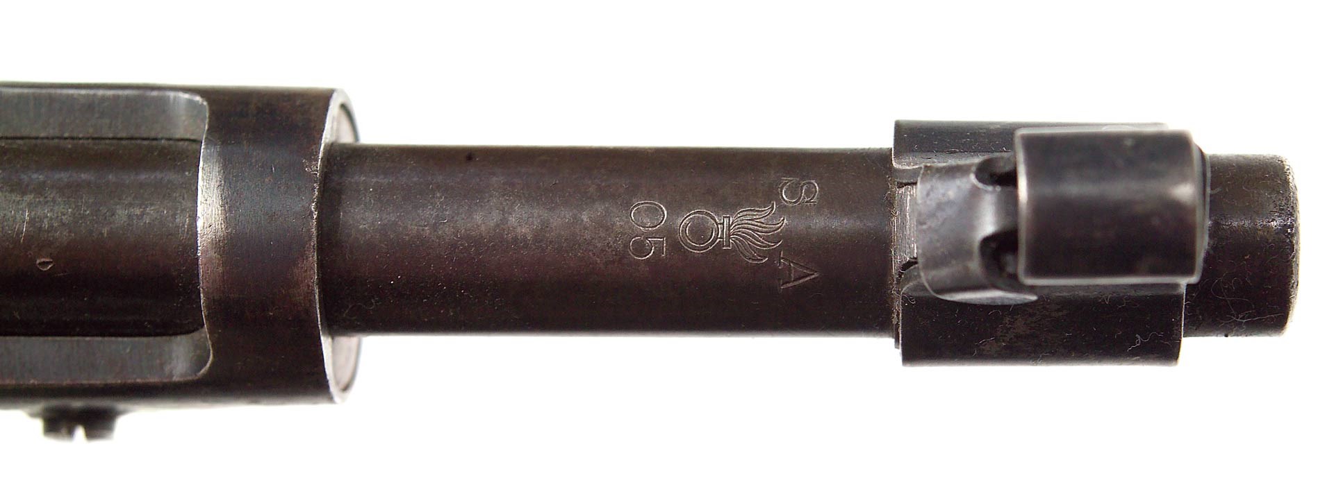

The 17" sword bayonet we know as the M1905 (above) was the result of their efforts. This .30-’03 barrel (below) was made at Springfield Armory in 1905.

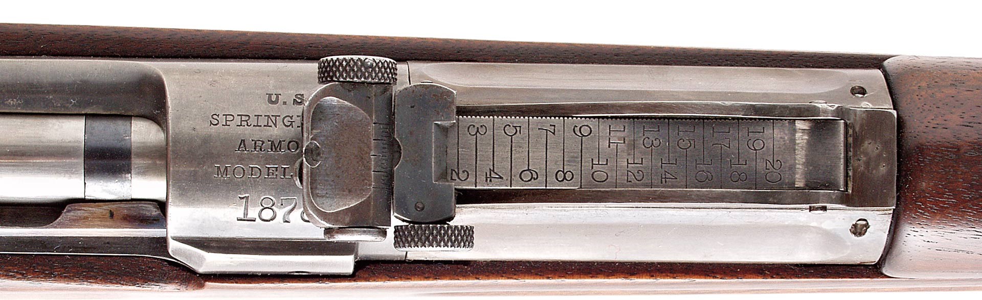

The sights of the original M1903 (above) were soon replaced by the 1905 model that offered better windage and elevation adjustments.

Widespread dissatisfaction with the ramrod bayonet of the original M1903 forced Gen. William Crozier, the chief of ordnance, to assemble a committee charged with developing a replacement.
